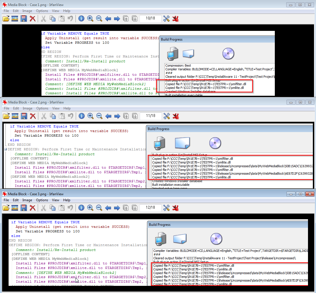

I created a project to test this in a minimized level (please find it attached).
I tried 3 scenarios (please find the outcome of all in the attached picture).
In Case1 I installed the files one, files got them bagged 1 time - OK.
In Case2 & Case3 I installed them twice to different destinations (with and without a second WEB MEDIA BLOCK),the files got bagged 3 times - NOT OK.
Based on what I understood from your last massage in the 3rd scenario I should have had them bagged again 1 time, right?
Did I understand something wrong?
Can you please let me know how can I manage to bag those file only once, but install them twice to different folders?

Re: Upgrade to IAX2
Postby FrancescoT » Fri Apr 10, 2015 2:08 pm
Dear Tamas,
with my previous post I have only described the possibility to reduce the number of the web media block created and in order to reduce the size of the generated files (the sum of them if more blocks are created).
A single media block that includes all the "Install files" command, it will be smaller in terms of file size, if compared with different web media blocks created to hold the same files.
That's the only applicable solution.
Unfortunately, it's not possible to skip the inclusion of a file, if the same is used multiple times with different "install Files" command.
Each "install Files" command generates a unique entry with the Web Media Block and it's not possible to override or to skip this behavior.
Users browsing this forum: No registered users and 74 guests
