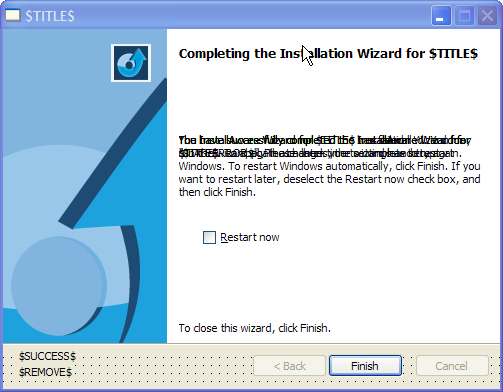

Hi Michael,
Well, I haven't made any serious changes to the "finish" dialog (except to modify header text), but I don't see the checkbox... at least not in the dialog editor. It's there when I run the setup itself, but not when I edit the dialog.
I'm attaching a screenshot of my finish dialog.

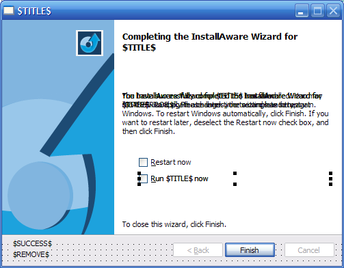

- Posts: 3452
I've attached a normal appearance. I can only figure your dialog control got deleted accidentally.
