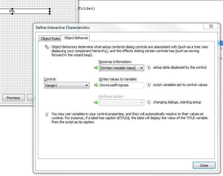

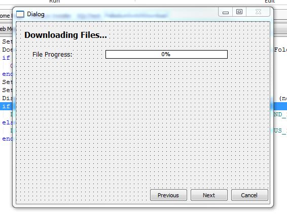

Also, here is a screen shot of the custom Dialog:
Progress 01.JPG (94.84 KiB) Viewed 9456 times
Progress 02.JPG (79.05 KiB) Viewed 9456 times
I really appreciate any help you can give me.

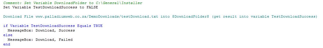

Firstly, here is an image of the code i'm using to test a file download. Thereafter is a copy and paste of the actual MSICode i'm using.
Download File 01.JPG (32.72 KiB) Viewed 9431 times

Ok, so when i test the above code, the messagebox pops up indicating that the file did not download successfully. I also check the folder location and can confirm that the file wasn't downloaded. Also note that I commented out the variable DownloadFolder in the above code as i declare it elsewhere first.
I'm probably missing some simple command that i'm not aware of to get this file to download or perhaps i'm not wrapping it with the correct code block. In either case I'd appreciate your help again.
