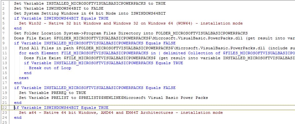

So here's some more info...
I modified the code of the Check for Microsoft Visual Basic Power Packs.mia script (see attached) to check to see if the system is a 64 bit system and to switch the installation mode (temporarily) to 32 bit mode thinking that when it went to go look for the program files folder, it would look at the Program Files (x86) folder. But what I discovered X3 was doing was much more interesting...
