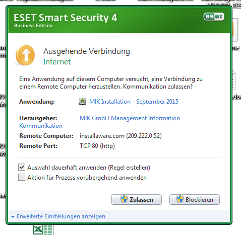

mikKummerfeld
Posts: 252
Location: Konstanz, Germany
Re: InstallAware.com Connection at Setup startup
Postby mikKummerfeld » Tue Oct 06, 2015 1:16 am
Our customer send me this screenshot. That means in English, that the Setup wants to establish a Connection to InstallAware.com after Startup.
How can we disable that?
Postby FrancescoT » Tue Oct 06, 2015 12:17 pm
Dear Heiko,
a generated package tries to establish such connection, only when a trial version of the product has been used to create the setup.
That said and because I am sure you used an activated copy of IA, I have the feeling that "maybe" such AV tries to alter the running exe and causes some errors with the internal license data.
