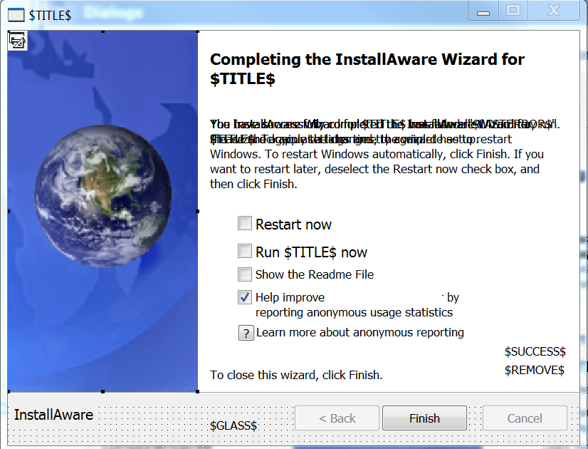

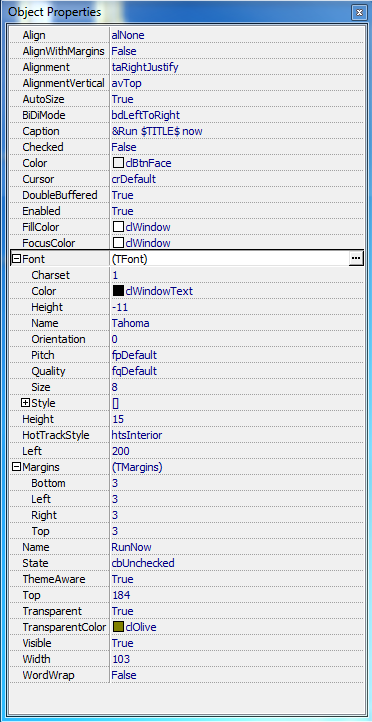

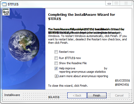

I am having the issue where I have added several radio buttons to my finish dialog next to the 2 default ones. They all work and look as expected (see sample 1). when the installer is run or the project is open in 150% magnification the size of the original radio boxes are different than the ones that I added (see sample 2). I have also added pictures of the settings for one of the original radio buttons and one of mine (samples 3 and 4). Do you have any ideas why they are different sizes at 150%? (heights are -17 and -22 at 150% and both are at -11 at 100%)

Re: radio buttons in 150% magnification
here is the 4th picture
- sample4.PNG (54.2 KiB) Viewed 7124 times

Dear sol952,
honestly I don't understand where is the problem with the "check-box" controls (they are not radio buttons).
With both screen shots you posted, the font size is Always "-11" and the same happens running a quick test on my machine.
The font size is the same when your run the installer in 100% (here Control Panel\Appearance and Personalization\Display) not not when in 150%
Sample 3 and 4 are both in 100% and are two different check boxes. #3 gets larger than #4 at 150%. I was just showing that they are the same in size and setting but the size is different.
