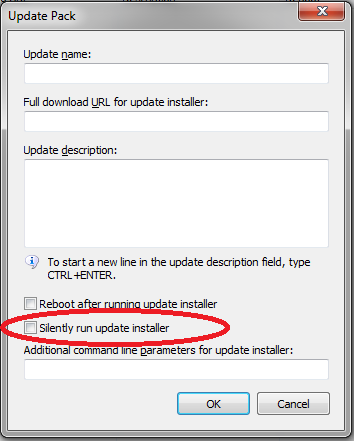

if the patch gets installed correctly when this runs manually, the same should happen when the patch gets installed from a web update. Supposing of course, that the same identical patch file has been used with the update pack.
At any rate, for test purpose you may try to disable the "Silently run update installer" flag in the update pack settings.
Doing in this way, the patch will run interactively and it should display a message in case of errors.
Furthermore, you can also use the "Additional command line parameters for update installer" field of the update pack settings, to specify where to store a log file of the patch installation process.

I disabled the "Silently run update installer" flag in the update pack settings.
It's working fine.
Appreciate you :D

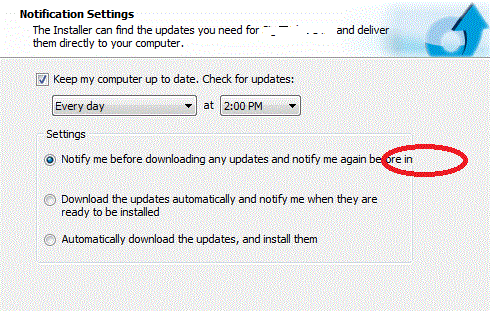

a. Start up screen come up, followed by welcome to myproduct updates screen, click next
b. Notification settings screen come up, here we can schedule for updates. (screen attached)
c. Then log on credentials screen, Entered user name & password
( I tried without password also)
d. Finish
After the scheduled time, nothing happens.
( I think, setup is not run. it's unable to resolve the & invoke the setup files )
For download & install, there are three options like Notify me before download & install, Automatically download and install etc., I tried all of them.
Questin 1. How do i skip run time checks for patch because it's taking longer time.
OR Actually i do not want to show start up screens for updates, how to hide these startup screen for manual updates.
And even i do not want to show 'update setup welcome' screen for Manual updates.
Question 2. Do i have to make any changes to update script for scheduled updates?
Appreciate your comments.

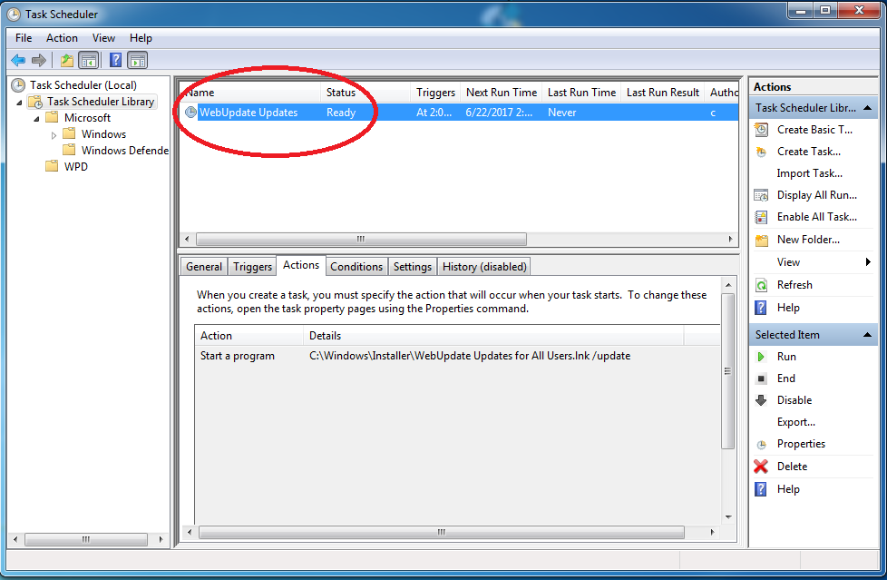

concerning your problems with updates, I can only suppose that "Probably", it exists something wrong with your project settings or with your script logic. The logic that stays behind the update functionality is extremely simple and unless you made any customization that may have altered the update functionality, this must work as it is.
When the updates are deployed using the "Schedule updates (similar to Windows Update)" mode, the update script creates a "Scheduled Task" on the target system. This task is based on the settings entered with the "update_setup_schedule" dialog and once confirmed the "Notification Settings", the "Task" becomes immediately active.
This TASK can be easily checked by inspecting the "Scheduled Tasks" of the target system (Control Panel -> System -> Administrative Tools -> Task Scheduler).
Please note that by default, the update script uses the project name to assign the task name ("$TITLE$ Updates") and in my case, I used WebUpdate for the project name.
For test purpose, you can also force the task (...the update process) to start immediately. This can be easily done by selecting the "Run" command of the Task dialog. Alternatively, you can manually run the command line defined with the "Task Action".
