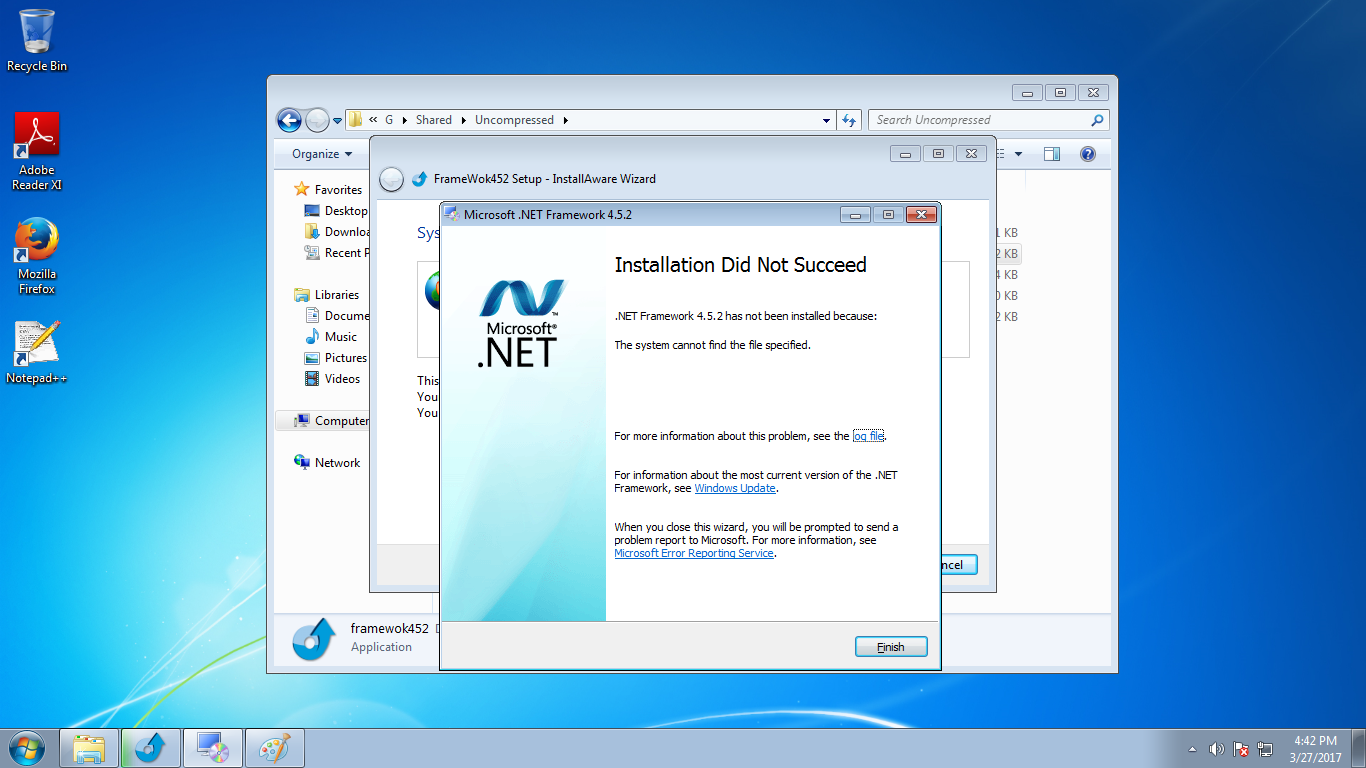

Re: Studio Admin X3, CD/DVD Installer Problem
Unfortunately, mine is not working still. Is there a way I can debug or log the things to figure out what's going wrong.
Pictures attached for clarification:
Just to mention same setup source compiled as "Single" run fine on the same machine.
Dear HammadAsghar,
for what I see, it's the .Net installer that fails to run and I am not sure if this stores a log somewhere on the target machine.
At any rate, it sounds very strange that the same issue isn't replicable when running a single compressed exe. The Net installer that gets included it's identical and this regardless of the build type selected. In addition, with a Un-Compressed layout the various setup files are just copied into the target location.
How did you run your test? Did you use a Clean machine where just the OS is installed (no other software or anti virus application)?
Have you tried to run the same package on a different machine?
Yes, .Net Installer log reflects some file missing, and Yes this is strange to me as well that same installer when compiled differently works fine on the same machine.
No, nothing else is installed on machine, I am testing it in Virtual Machine (VmWare) environment. I have conducted the test couple of time but same image (and I believe OS/Settings have nothing to do in this case).
It's getting urgent on me, so please help me out in this situation, I have to ship my product soon.
