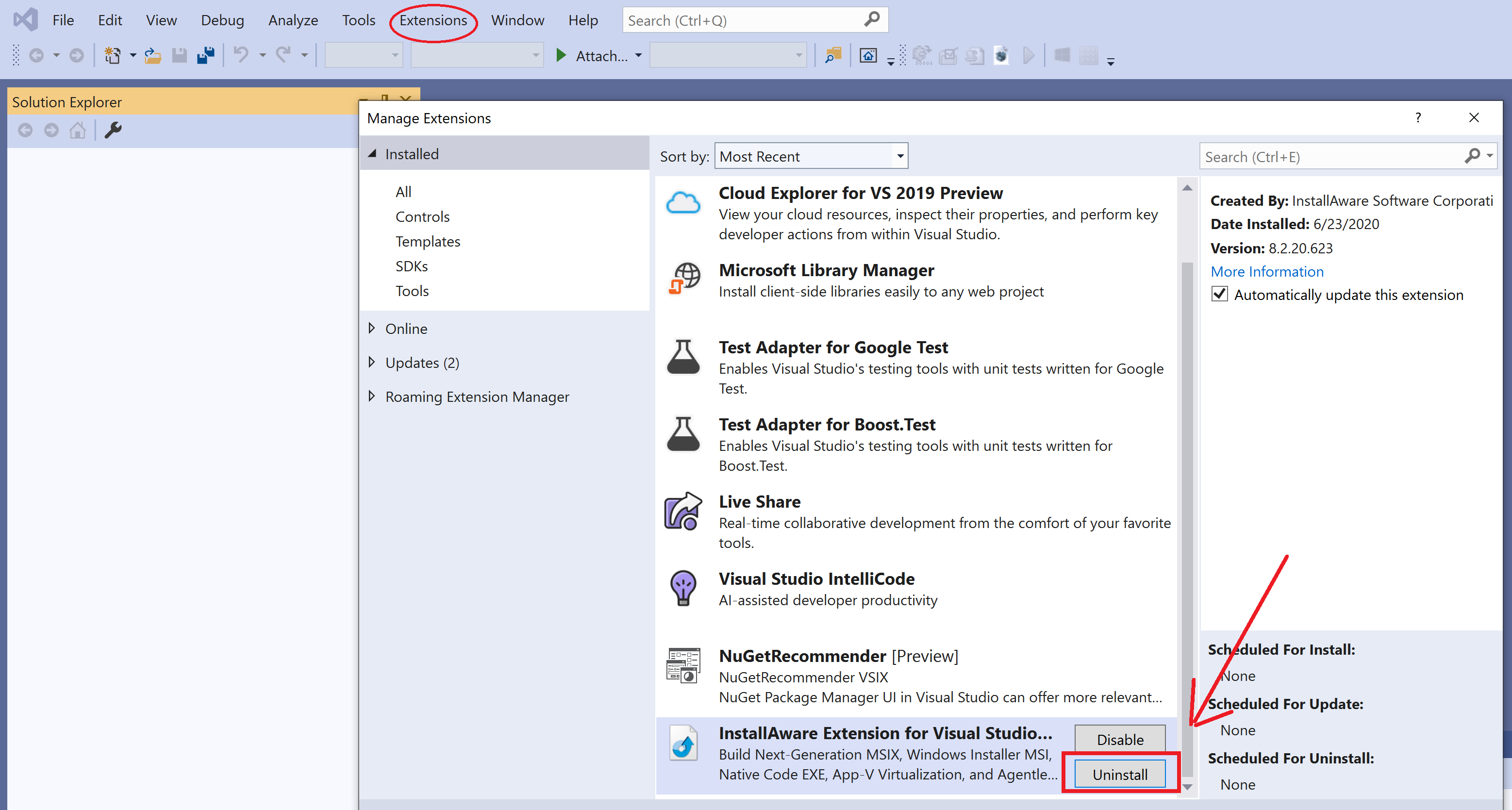

1. Uninstall the VS Extension from Visual Studio.
Launch the VS 2019 IDE, Extensions menu -> Manage Extensions. Then select to uninstall the Extension.
*follow the on-screen instruction to complete the uninstall...you will need to close and restart VS to complete the process. Once the Extension removal has completed, Have care to close the VS IDE before proceeding with the next point.

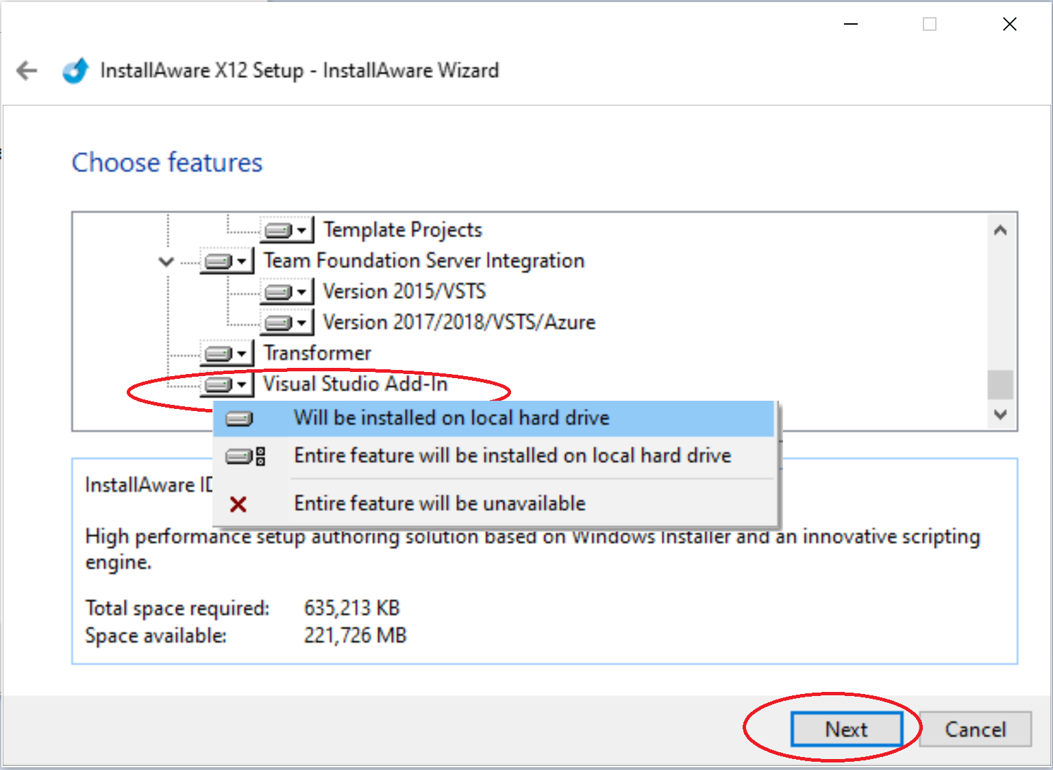

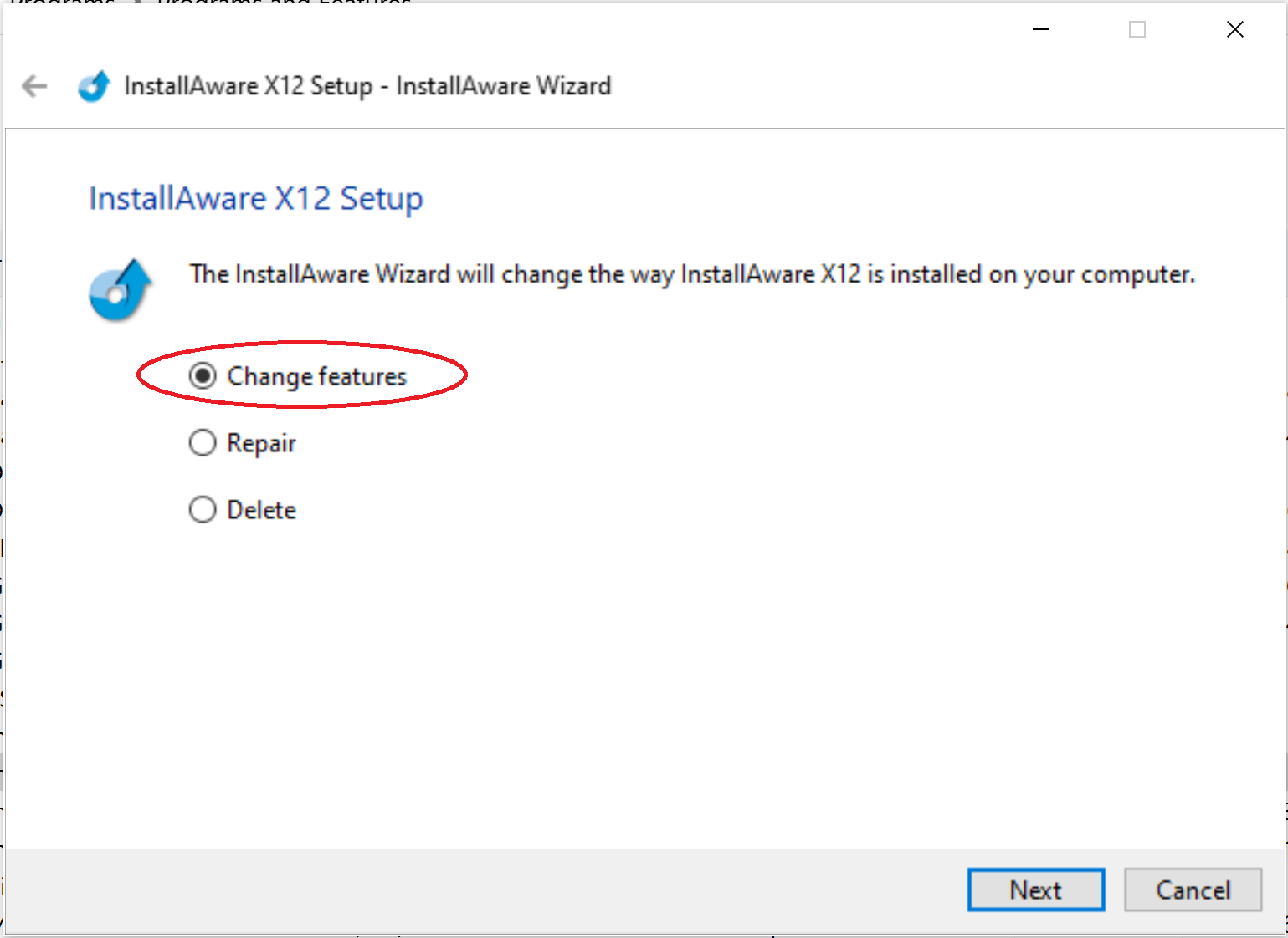

Run the IA X12 trial installer. Because on your machine IA was already installed, the setup will run in maintenance mode. Select "Change features" from the wizard, then next.
Scroll down the features list, locate the "Visual Studio Add-in" component, choose to install it, and then Next to confirm.
Once the IA installer has completed (You may need to apply once again your personal license file at the end of the process), launch Visual studio 2019, and finally check if the problem is now fixed.

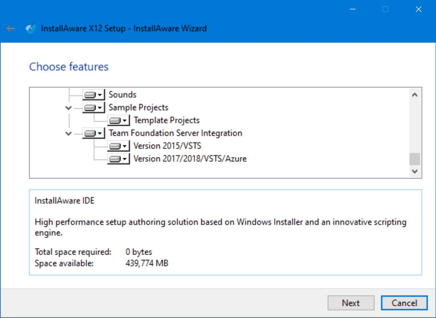

When I try to change installation, I don't see this add-in (image below).
I uninstall IA X12 and try again to install but still I don't see this add-in. When I try to install on my private laptop then I see add-in.
I before have installed IA X11. It may be in some folder exists old installed settings and this block to I see VS add-in?

Such "Visual Studio Add-in" component, it will be only listed if you are installing on a machine where VS is already installed as well.
Are you installing on the same machine where you have VS 2019 installed?

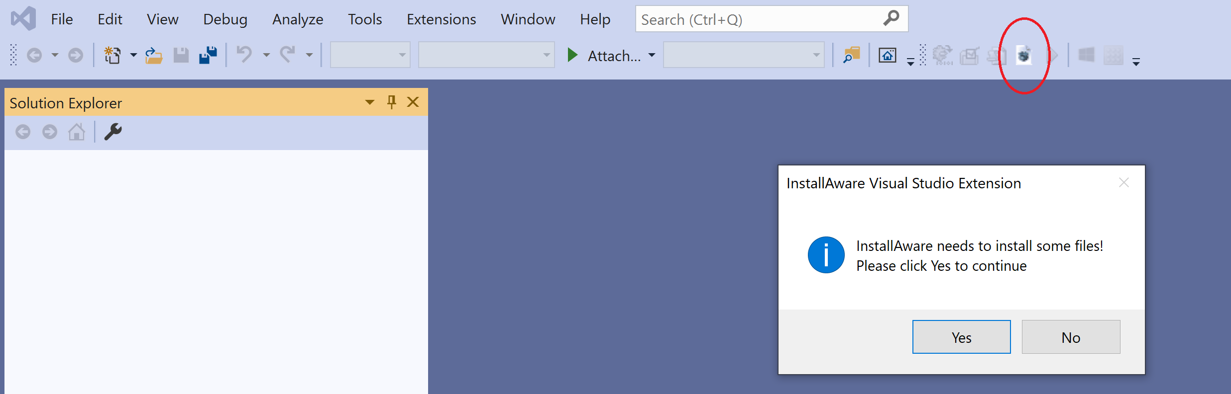

5. Launch the Visual Studio 2019 IDE, and install the "InstallAware Extension" from Visual studio (Extensions menu -> Manage Extensions). Follow on-screen instruction to complete the installation of the Extension (you will need to close and restart VS to complete the process).
6. Launch the Visual Studio 2019 IDE once again, click the IA icon on the "IA Extension toolbar", and then select YES to confirm the installation as requested by the message-box.
(*) The X12 install process will start automatically once the download is completed.
7. Finally proceed with the X12 install process as you usually do, and have care to select to install the edition that matches your licensed edition.
I just tested the above steps on a test machine, and both "IA and Extension" were installed successfully.
