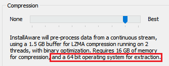

1) What are the system requirements for the different compression strengths? The UI gives requirements about compressing, but not decompressing, for most of them. Some don't mention any requirements. I need to confirm that our VM's meet these requirements.

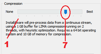

1# The compression UI reports the requirements for each one of the compression settings. When only Compression requirements are reported, it's intended that no specific requirements are required for decompression. Otherwise this is reported. For example:
I may suggest you to try using the default compression level (7th notch from left to right).
