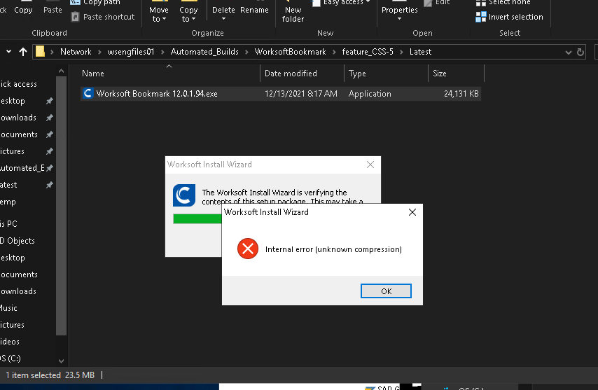

Hi, We started to get this compression error (attached) randomly with absolutely NO change to the installer. Any idea why or how to resolve it?

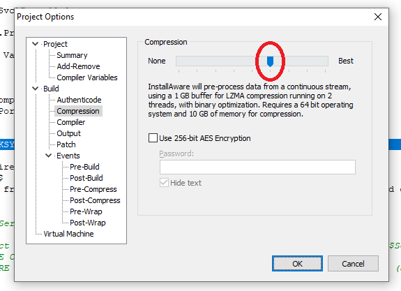

Yes it is reproducible on any target. It happened after re-compiled the installer (happens with every build). I've not made any changes to default compressions level. (attached the screenshot below)
And no new third party AV. The installer from previous builds works fine.
Is there a possibility that this could be caused by:
a. changes to installable files?
b. multiple merges to different branches?

Sure Francesco. Pls let me know how can I send it? Also it used to not happen, maybe after repeated merges / recompiles it triggered? If I were to manually modify the compression rate to something else, it will work fine. This is the 2nd project this has happened, I wanted to know what triggers this behavior.

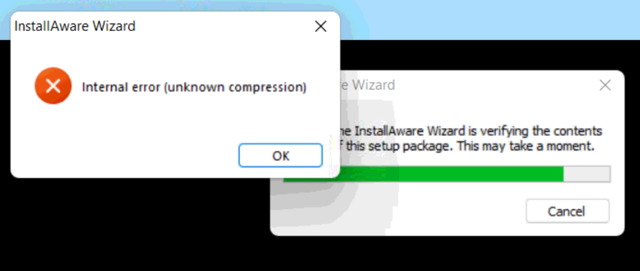

Hi Francesco,
I am also experiencing this problem after upgrading from IA X4 to IA X15.
This issue occurs after changing the compression level and I am currently trying to find a compression level where this error does not occur.
-Mohamed

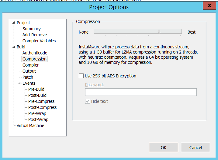

The issue here was fixed with lowering-down the compression level as below:
You could try the same.

Thanks Francesco,
Changing to that compression level resolved this issue.
Do you plan to update the product so that it is not possible to select unsupported compression levels?
-Mohamed

Apparently not - I have the same error.
- instalaware_unknown_compression.png (76.95 KiB) Viewed 45930 times
