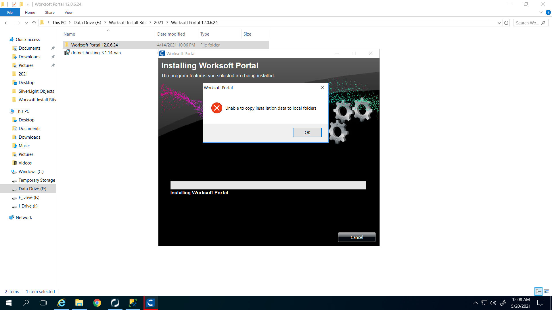

Hi Francesco, The installer only installs some files to target dir and creates app pools in IIS. The problem is it doesn't seem to extract the full installer into the temp directories. We've confirmed that AV is not running and yet installation fails with attached error. So I was wondering if there is any "whitelisting" that needs to be done for any folders.

- InstallError.png (153.23 KiB) Viewed 17801 times

No Mallika, there isn't any "whitelisting" that needs to be done for the target folders.
How are you testing the issue? Are you using a CLEAN TEST MACHINE?
Do you have any chance to share a minimal replicable project?

Hi Francesco, the problem is I am not able to replicate it at all. This problem seem to happen on few of our customers and am not sure what is different about their environment that causes this. They don't seem to have any Antivirus software and they are installing as admin user. So I am not seeing any reason they would run into issue. The same exact installer would run fine in some environments.

It sounds like a typical AV interference, honestly. If the same isn't replicable on any target system, the problem is surely related to the failing target.
I may suggest you, if possible, to personally verify if they have or not a third party AV installed. Many people don't even know to have one installed.

Thanks Francesco. Odd thing is, we provided 5 installers (of 5 different products) and 2 of them install successfully in that problematic environment but not the 3 of them. If AV was the culprit, then why only those 3?

What you've provided is actually a perfect description of buggy anti-virus behavior - inconsistent execution being a tell-tale sign of the same.
We really do ask for your kind understanding that we cannot work around random issues in poorly written third party software.
The only anti-virus vendor we may formally support is Windows Defender by Microsoft.
