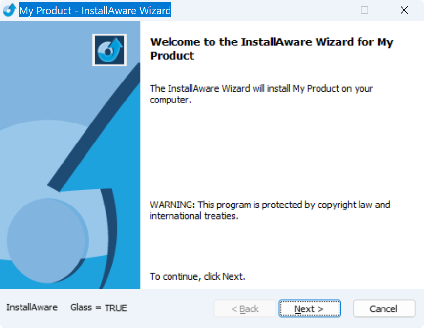

Same here. I didn't find anything to change it.
Setup Windows 11 - light theme with blue accent color.png (115.13 KiB) Viewed 17802 times

Seems I found it. There's a Glass tab in the Dialog designer, with a component called VistaGlass. It has to be placed on each form, with GlassEnabled set to True and GlassTop to 34.
InstallAware's sample projects mostly use it. So the 34 isn't a number I made up myself :)
You may have to put a replacement for the system icon and the title caption into the client area of the form.

Postby FrancescoT » Tue Aug 16, 2022 6:20 am
Dear Peter,
We are aware of the issue with the Mica Mode. Sadly Windows 11 is a moving target and this behavior can change from day to day, as updates are rolled out from Microsoft.
We expect these issues to be resolved as the OS settles down gradually over time.
Unfortunately, currently the only workaround is with disabling the VistaGlass to get rid of this kind of caption. However, this will also eliminate the Mica surface at the bottom of the dialog.

Postby FrancescoT » Mon Oct 31, 2022 9:11 am
This has been fixed by the latest IA x15 minor update v.32.22.
- Caption painting with Glass on Windows 11 (all versions)
