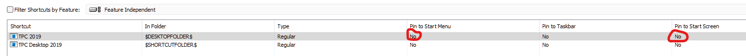

I can't get a shortcut to show up in Windows 11 Start Menu. Tested OK in Windows 10.

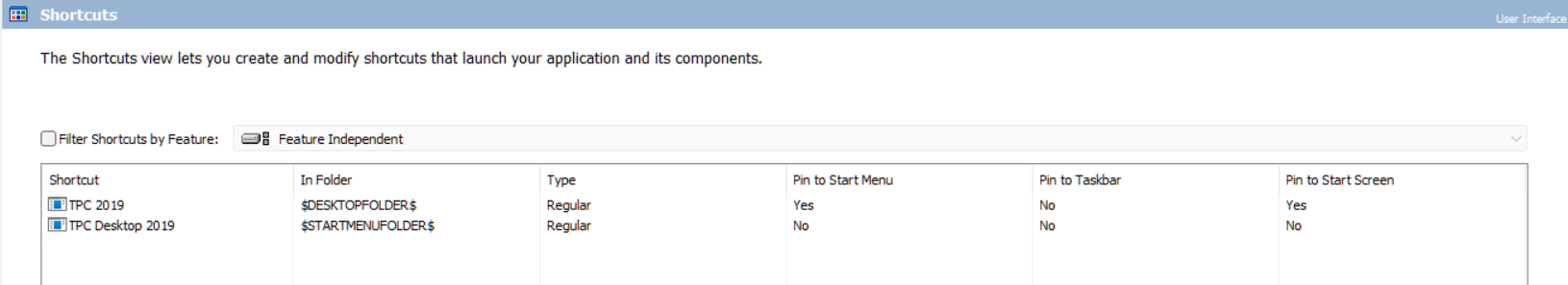

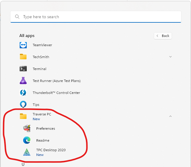

InstallShield created the TPC Desktop 2020 link shown here under the Traverse PC folder. They make it so simple. I want IA to do the same thing.
I've added the shortcuts I want to the IA IDE. The TPC 2019 works great. The TPC Desktop 2019 doesn't. I can't get the shortcut to show up in the start menu at all. Even if I don't put it in the Traverse PC folder.

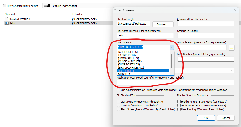

What should this Create Shortcut dialog look like?
I tried adding the startmenu dialog and that didn't help.

Re: Can't create shortcut in start menu

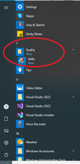

Please have a look at the attached project. This creates a "Hello" shortcut in the Applications Start Menu Folder.
It looks like you are sending the link to the shortcut folder, but it doesn't show up in the pulldown list in the properties dialog.
1. Do I enter $SHORTCUTFOLDER$ manually?
2. Why isn't it in the pulldown list?
3. Where does your documentation tell me what $SHORTCUTFOLDER$? is and when to use it?
4. Why didn't IA set this up for me when it converted my InstallShield project?

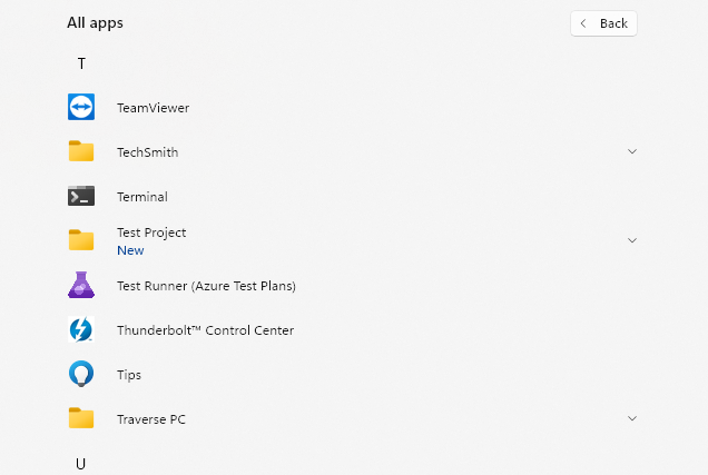

I built your testprj and installed it. I changed a few variables to mimic what we want.
When the start menu is first opened, I see the shortcut
Then, without doing anything, after about 5 seconds, the short cut disappears
Reopening the start menu and rebooting the computer doesn't bring it back.
What do I do to get the shortcut to stay in the start menu?
I figured it out.
As soon as I changed the circled Pin options from Yes to No the TPC Desktop 2019 shortcut stays in the Startup Menu for Windows 11 and doesn't disappear.

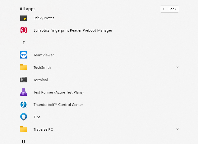

- Posts: 17
- Joined: Sat Oct 08, 2022 9:15 am
This morning (the next day) 2 of the Start Menu shortcuts are missing - TPC Desktop 2019 and TPC Desktop 2022.
1. both are still installed
2. both still have icons on the desktop that work
3. both are still included in C:\ProgramData\Microsoft\Windows\Start Menu\Programs\Traverse PC
What is going on?
What is going on?
Sorry to hear of your troubles, but this sounds more like a Start Menu bug at Microsoft's end than an InstallAware issue.
For the record, no other product can pin apps to the Start Menu at all, including the one you referenced above.
