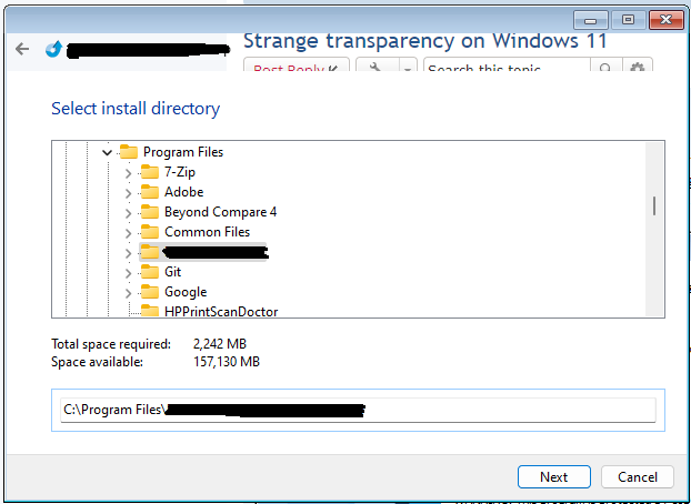

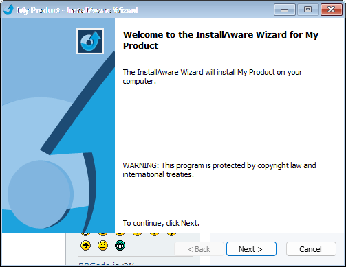

I have noticed that our installer programs have strange transparent sections on them when installing on Windows 11. I have attached an image of a sample install create with X14 showing the issue. while this test installer was just created from scratch, our other installers have been around for many years, This issue does not occur on Windows 10 as far as I can tell, nor is the issue visible in the dialog sampler.

I can't replicate anything like that. This may depend (for some unknown reasons) on your testing machine.

I have managed to replicate it on 3 different machines. The sample installer is about 2.7 MB if you would like to see it or the project file

Re: Strange transparency on Windows 11
We are seeing a similar issue, but just top area of the dialogs, under the title bar. The screenshot is a dialog on top of this topic page. We are using InstallAware X15 Build 8.1.2022 (Nene Hatun). It's happened with installers built using Windows 11 (my dev pc) and Windows 10 Pro (our build pc).
- InstallAwareDialogTransparentArea.png (21.34 KiB) Viewed 18575 times
I investigated this more. Our installer dialogs are customized from the IA supplied Aero dialogs. Each dialog has the VistaGlass control in the upper left corner. It's causing the problem when the built installer is run on Win 11. When I changed the control's GlassEnabled property from True to False, the problem does not happen.
Bob, this issue was resolved in InstallAware X16. You do not have to remove glass regions from your dialogs and you will properly see glass effects anywhere you use them in your setup dialogs across all Windows operating systems, all from a single binary as in the illustration below:
