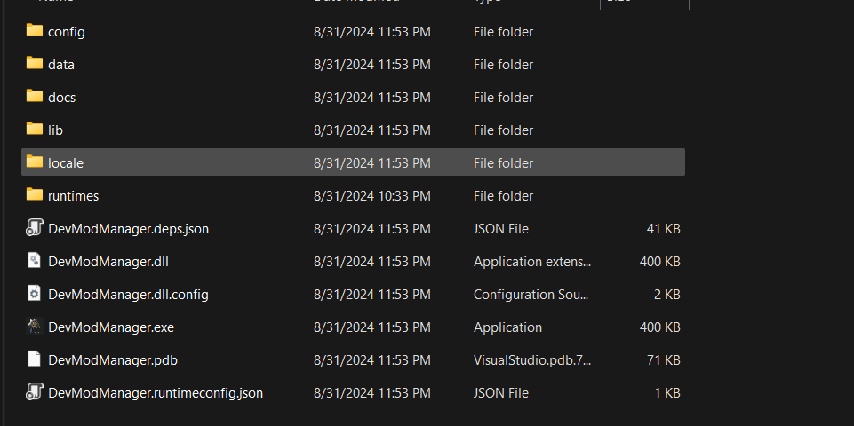

That finally got the installaware to compile, and generate an msi, but then it told me "could not access netowrk location \$\filename.deps.json
The only file by default shows as filename.exe, and it points to the filename.dll from the release folder.
If I build just that, I get a single huge executable - which definitely won't work, because I have folder path/file dependencies.

Well.. apparently I didn't understand a few things... the single monolithic executable does actually work, but I'd had to make some modifications to the program to allow it to do so.
I had depended on a config file and a database file in folders local to the app.. I'd built them into my distributed output file.
These did not get picked up as things that needed to be distributed.
But when I added them to the builder, to push them to localappdata, things got much happier.

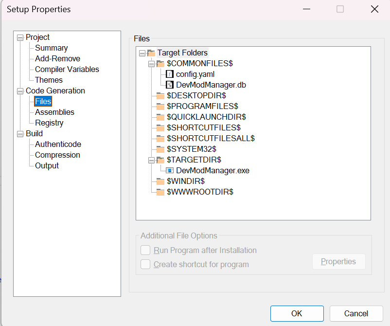

When I build the project using the "standard" build button I go into the settings and have it copy my config.yaml and the app.db file over to the by using COMMONFILES
Only the .db file is copying.
I've attached the iaext.zip
Is manually adding all the folders like the docs, database, config files normal?
Well.. let me pause a moment... since i can't create folders there without scripting it in -- i don't see any way to add the folder structure.
With the very large size of the produced single executable, and looking back at the archive folder, it appears that everything there + the "core" of .net core gets added into the executable. Is there an option to exclude the .net core stuff?
