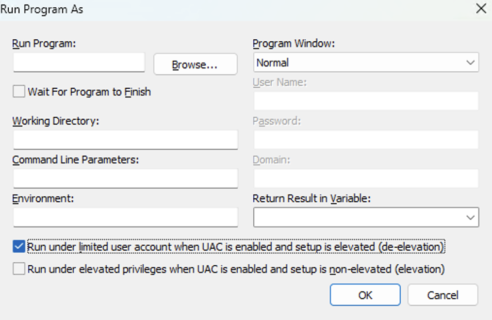

1. Use the Run Program As command with a de-elevation request, so your product never launches elevated to begin with:

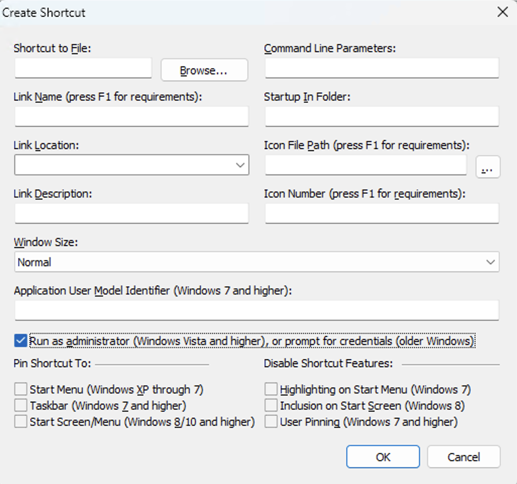

2. Use the Create Shortcut command with an elevation parameter, so your product always launches elevated from its shortcut:
