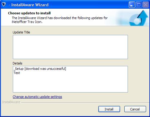

My problem is following:
I uploaded the file with generated patch (_setup.exe) and updates.ini file to the server. The installaware setup correctly downloads and reads updates.ini file and informs me that there is a new version for download. It is preselected in the list, all I have to do is click on 'Download'. A split second later a new balloon is showed, telling me that a file was downloaded (which was not the case). I can open the update form, but the 'Update Title' field is empty (see the screenshot).
What is the problem? I do not quite understand how is the info from ini file connected to generated patch file?

This doesn't appear to be a problem with the patching mechanism that you are experiencing.
I think the problem is with the delivery of the web updates. The download is not succeeding, and maybe you have some configuration errors in the INI file, or your web server.

Well I don't thnik there is a problem with the web server - it is possible to manually downolad the patch file without problems. However, I do not see the name of the patch file anywhere in updates.ini file. I have read all the help topics you mention already. I generated my patch file with defined update pack and connected previous version to it but still... Am I missing something here?
Here is the content of my ini file:

The URL is the URL to your main site. It is not the URL to your actual patch file!
- Posts: 3452
Sorry, there's really nothing more I can suggest or help you with, unless you provide more details on what's going on!
The URL should be a complete URL/path to the update setup. This url, when copied and pasted into a browser should start the download, if it does and it is EXACTLY the same in your ini file, the update mechanism will work everytime.

Jimo, thanks for support. It seams that the URL must be completely written, beginning with http:\\\\... in order to get the file downloaded.
There is a problem on installation of update if the program is already running - the installer can not install the new version over the running one. But I hope it will not be a great problem for end users.
