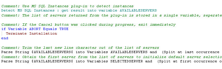

Howdy,
I'm looking at the SQL Server Connection example and I need to modify it a bit. I want AVAILABLESERVERS to ONLY return all SQL instances that contain the letters 'APRO' in them (my instance name). Using Parse String I can get the first or last instance, but without a while loop I'm not sure how to get them if there are more than 1 instance on the network.
Also, how can I get the machine name of the local machine if I want it to be the server? I need to update a UDL file with 'machine name\\instance' if the server is installed locally and I don't see a global variable to do this.
Thanks for looking.

I'm looking at the SQL Server Connection example and I need to modify it a bit. I want AVAILABLESERVERS to ONLY return all SQL instances that contain the letters 'KeyExpress' in them (my instance name). I have read above solution. In that it says about using 1) Lable and GO to label 2) Get System setting. But I did get it so please give some detail solution for it.
The script in example is as per attached file, So where should I make the changes so I can get only instance name "KeyExpress"

Hi Raj,
This is what I did. I was looking for an instance named 'APRO'. You could easily modify this to just return the SERVERNAME only. Also, because I couldn't determine if I was just getting the servername, or the servername plus the instance name, this script actually tests each instance that either is just the servername, or ends in APRO, for the database that I'm looking for.
