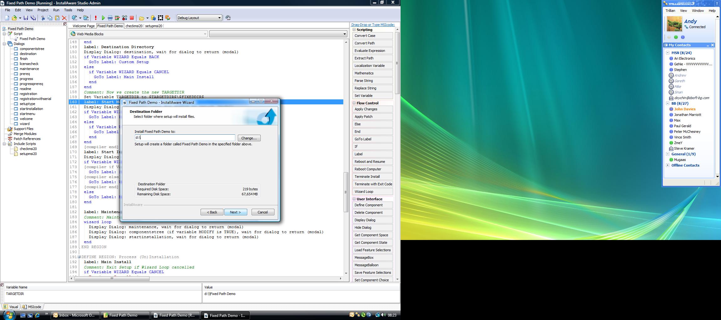

Hi Doron,
Just tested, seems to work correctly when you specify a drive as the target.
Please see the attached screenshot; if you run the Debug build in InstallAware, you should see the same - check the TargetDir watch during the installation - this should give you a hint as to what is wrong.
Also, be sure that the setup installs at least one valid file; if it does not, then the TargetDir is not created (my sample tries to include win.ini
