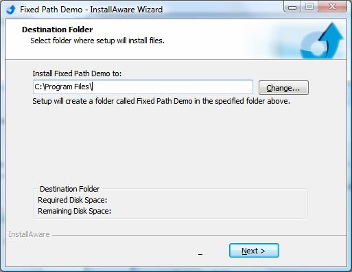

Ok, I follow now.
The Fixed Path 2 DOES do this, however not the GUI part.
It is not possible to update a control via the Browse (Change) control, so you can not force a specific part of the path to be appended to the control immediatly. This is because the script language can not trap actions that are occuring on the form unless it closes (when you can query and set the variables via script).
Because of this, the destination form in the example has been customed to include the line:
"Setup will create a folder called Fixed Path Demo in the specified folder above.".
Please see the attached screenshot.
