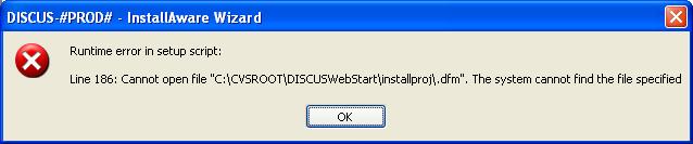

I'm having a somewhat similar problem, again using IA 6.6 in debug. When I try to run in debug I'm getting a pop up error msg that says Runtime error in setup script: Line xxx: Cannot open file "C:\\xxx\\xxx\\.dfm". The system cannot find the file specified. an example error is attached. Note the missing dialog file name.
I was using debug because I had just put a new dialog into my installer, so I thought maybe it had gotten corrupted. I finally took the new dialog out and reverted back to .mpr and mia files I knew were working. Tried debug here and got the same error msg. Finally tried stepping thru the script and I hit the error upon stepping into the wizard loop command.
After this error comes up, IA is locked up. Have to end the miae.exe process with task manager.
I wish for an IA 6.6 fix.
