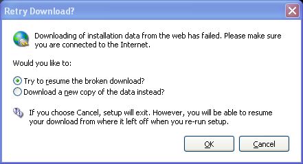

I am having a problem whereby, on a machine that is behind a proxy in a corporate environment, the installaware client is unable to download a web media block, giving the error:
Downloading of installation data from the web has failed. Please make sure you are connected to the Internet. Would you like to try to resume / download...
(screenshot is attached)
I can, using IE, navigate to the 7zip file directly using Internet Explorer and it downloads Ok.
The same installer can download the web media block succesfully when running on a machine that does not use a proxy.
