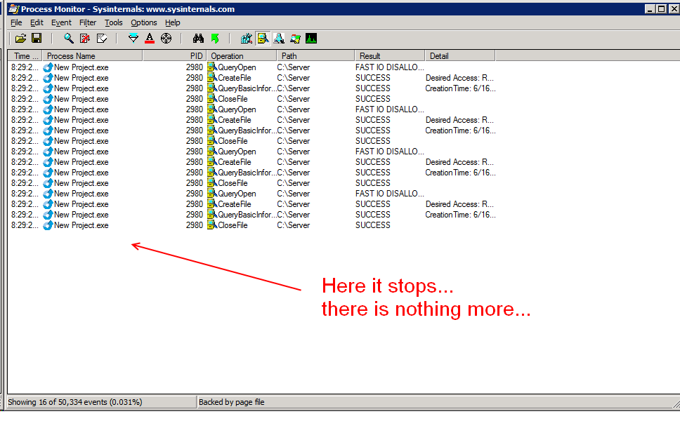

I'm not making it up. On the 2008 R2 ENG system it really doesn't work. I have tried everything including the main Administrator account.
Here is some evidence - I used the "Process Monitor" to check if the problem is caused by the missing rights.
Result on the working system (DE):
Proper behavior on the 2008 R2 DE system
result on 2008 R2 DE.png (193.63 KiB) Viewed 25668 times
Here is what I got on the not working system (ENG):
Wrong behavior on the 2008 R2 ENG system
result on 2008 R2 ENG.png (57.25 KiB) Viewed 25668 times
It looks that the InstallAware is not proceeding with the installation, installutil.exe is not started at all.
I doubt that it has something to do with the language (DE/ENG versions). Something must be wrong, but what?
