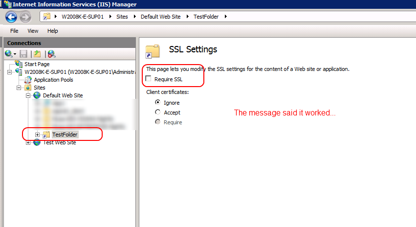

I have performed a test of "Set IIS Property".
What I'm trying to do is to set the SSL certificate for a given virtual directory.
where:
Results on Windows 2008 R2 EN/DE are identical. One of the system has the IIS Metabase Compatibility enabled, the other one not.
1. Step 1 - configuration of the test system
2. Step 2 - the first message box. As you can see the "Get IIS Property" didn't work.
3. Step 3 - the second message box. Surprisingly is appears that the "Get IIS Property" worked... Everything should be fine...
4. Step 4 - it didn't work...
(attachment in the next post)

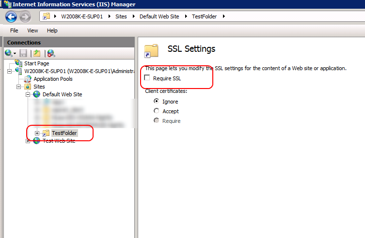

Set Variable MD_ACCESS_SSL to 8
Get IIS Folder Property "AccessSSLFlags" into variable SSL_FLAGS from site #1/TestFolder
MessageBox: Information, Current SSL Flags: $SSL_FLAGS$$NEWLINE$Setting the new flags to: $MD_ACCESS_SSL$
Set IIS Folder Property "AccessSSLFlags" to $MD_ACCESS_SSL$ in site # 1/TestFolder
MessageBox: Result, Current SSL Flags: $SSL_FLAGS$$NEWLINE$
Terminate Installation
where:
- TestFolder - is a valid virtual directory
- The server is configured correctly to handle SSL
Re: IIS7 - Get / Set Property Calls - Are you having problem
So I must say that the "Set IIS Property" is not working correctly on IIS7/7.5.
Best regards,
adi
