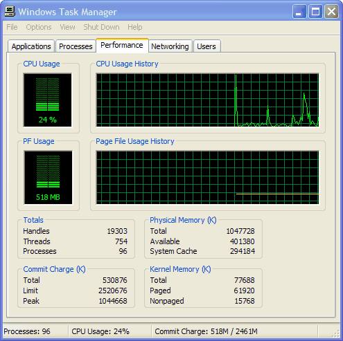

Thanks for all the input. I have tried the ideas presented but the problem persists. When miabuild.exe is finished, it seems to hang while attempting to shutdown. I hear the beginning of the sound it normally plays upon conclusion, but it is clipped (gets cut off). I wonder if this is significant. The build appears to have worked properly, the file is in the output folder and seems to be just fine. If I kill the miabuild process using Task Manager, it quickly ends and the script continues.

How much free virtual memory and total physical memory do you have on the build system?
Does lowering your compression strength help?
Are there any left behind folders in the build directory after exit?

There are no folders/files left behind in the output folder, just the setup.exe. Lowering compression strength has not made any difference. See the attached screen image for other details
