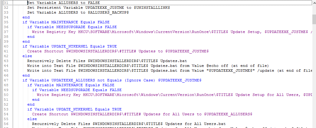

Here is the offending (?) code. Looks like it is trying to upgrade both the all users and me.
