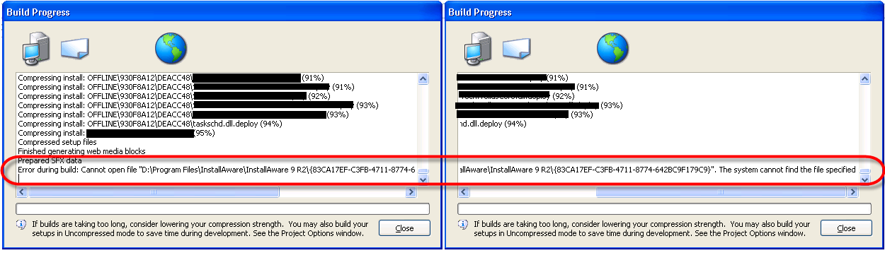

Every other compilation fails with some kind of File-Not-Found exception pointing to a non-existing directory (GUID), typically "C:\Program Files\InstallAware 9 R2\<GUID>\".
Most of the times I just have to compile it again, but losing a lot of time as this has to be done every 2nd compilation or so...
Whats up with this? The application seems a bit shaky to say the least.
An other thing is this madly flickering Build Progress Window...can't you guys sort that out?
Error During Build - File Not Found

Here you are, a picture showing the error.

It seems related to AV (realtime scan) actually...
I disabled the realtime scanning in MSSE and compiled the project three times with no problem at all.
I then enabled it and recompiled and boom- File Not Found.
I also noticed that the compilation time took twice(!) as long with realtime scanning enabled.
The IA process and project directories are now excluded from realtime scanning and the problem has, knock on wood, disappeared and compilation time is cut in half
