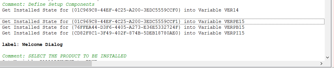

i am building an installer with 3 products .. is it possible to allocate each product have its own product code, so that when i run the installer it will check if the product is installed using those
different product codes.. find the attached img... i am checking if the package is installed. how can i st the product codes at run time so that the products will have these 3 static product codes which i will use to detect the installed product..

Postby FrancescoT » Wed Jan 21, 2015 5:24 am
Dear Anderson,
instead of your approach, create 3 different projects (one for each product) and then embed their installers in a wrapper package.
