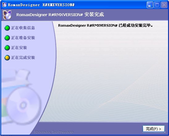

We are using a Compiler variable as part of the software title.
Set in the script,
Set Variable TITLES to $TITLE$ R#RMXVERSION#
This works fine in the default non-localised installations.
when running the installation the title is for example "RomaxDesgner R12.3.0.x"
We are now trying to get a Chinese (PRC) version working,
We have gone thorugh the Translation wizard (it now works on our script by the way, thanks for the fix :D ).
When you run the installation the title variable is now set to
"RomaxDesigner R#RMXVERSION#"

Postby Gareth Owen » Thu Mar 02, 2006 10:09 am
Here is an example screen shot
