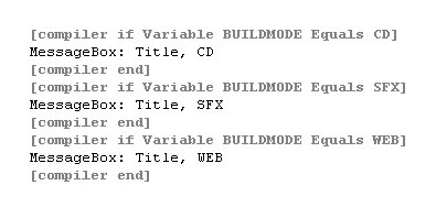

OK, I give up, I am trying to understand this BUILDMODE variable and I just can’t figure out.
The attached picture show some of the script that I added to my project, I was expecting that the script will show the appropriate message box depending on whether the build was a CD, single exe or web but no matter what I try I always get all the messages.
It looks like if the BUILDMODE variable was not setup at all. What am I missing?

- Posts: 3452
Hi Rene!
BUILDMODE is a compiler variable. So in your script #BUILDMODE# will be set to WEB when doing a web build, for instance.
If you try that sample, you will see that when you build it in web mode, the startinstallation dialog (the default one) has an extra check-box, which is missing in other build modes.

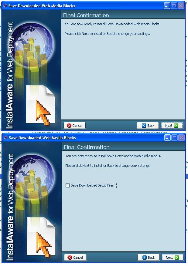

Nope, if I create a new “Saving Web Downloads” project and run the project as default (without the “Debug Build (allows setups to be debugged in IDE)” checked I get screen 1 (See attached picture)..
However, if I check the “Debug Build (allows setups to be debugged in IDE)” option and compile and run I get screen 2 (See attached picture)..
Now why would I get tow different screen if all I did was to check the “Debug Build (allows setups to be debugged in IDE)” option?
- Posts: 3452
As I have already explained...if the web media block files have already been downloaded previously, or are already available in your build folder as they will be when you do a full build, there is no need to re-save them.
Only when the main setup is found alone in its folder, without the web media blocks, will you see the save location prompt.
This is all documented in the setup script itself. You can just read through the setup script and save yourself some time - it will be faster than posting here and waiting for answers.
Of course, we are happy to continue helping you with your questions.

Well, when you are right you are right, if I only would have read another 5 lines I would have seen what was going on.
However, there is something to be learned here, it turns out that when you check the infamous option:
The files that are generated in the build directory are *Not* the same as when this option is unchecked, That was the reason why the program behaved differently when the option was checked vs unchecked. I didn’t know that and that really threw me off.
Perhaps a little warning message when you check this option that would pops up explaining that simple fact would be nice, it would have saved me 6 hours of misery!

- Posts: 3452
Yes, for compressed builds, debug build options do change the contents of the build folder.
A better alternative to debug builds is using uncompressed builds for testing during development - as they provide much faster build times...
