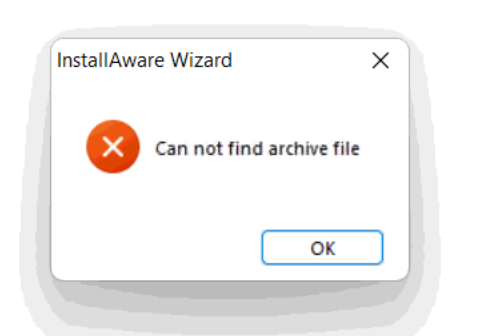

I had to change pc, so I had to install the last version of Install Aware and reinstalled my activation file.
I opened my install aware project that I was created with version 7 of IA and built the compressed single installing exe file.The install was built correctly.
The case is that when I execute it, after saying 'The InstallAware Wizard is verifying the contents of this package. This may take a moment' the message 'can not find archive file' appears. After that, the installation continues and my application is installed correctly.
How can I solve that?. I think that is something connected with the shared strings.
Can somebody help me.

Re: Can not find archive File
Dear Francesco
I tried it but the problem persists.
The complete message is "Cannot open compressed data stream" "Cannot find archive file"
I started a new installation project and when and when I run the new installer the same error is given.
One diference is that my new Pc has windows 7 64 bits.
I have no problems with my older Pc that has windows vista 32 bits.
Please help me
Please help me
is there any solution to this problem? I have the same problem.
- installaware_can_not_find_archive_file.png (28.49 KiB) Viewed 21468 times
I just need to know how to find out what is this error. How to make a debug log
This topic applies to InstallAware Multi Platform as well.
You may use the:
command line parameter to log your setups.
Please be advised that the issue referred to in this post was resolved more than a decade ago.
You may use the:
/l=<logfile>
