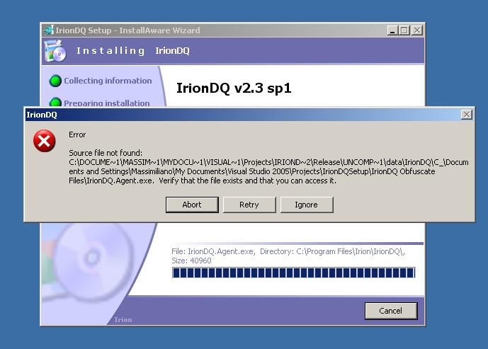

Postby maxupgrade » Thu May 18, 2006 2:38 am
Error screenshot is in attached ...
this configuration is correct ?
In the "Install Service" Dialog :
service file field :
C:\\Documents and Settings\\Massimiliano\\My Documents\\Visual Studio 2005\\Projects\\IrionDQSetup\\IrionDQ Obfuscate Files\\IrionDQ.Agent.exe
target folder:
$TARGETDIR$
This is the code :
    Get Component Local catalog Selection State into Variable SELECTED
    if Variable SELECTED Equals TRUE
      Set Variable TRIGGERSERVICE to TRUE
      else
      Set Variable TRIGGERSERVICE to FALSE
    end
    if Variable ENTERPRISESERVER Equals TRUE
    end
    Comment: Servizi
    Install Service C:\\Documents and Settings\\Massimiliano\\My Documents\\Visual Studio 2005\\Projects\\IrionDQSetup\\IrionDQ Obfuscate Files\\IrionDQ.Agent.exe to $TARGETDIR$ as IrionDQ Run Service
    Control Service IrionDQ Run Service: start on install [wait for completion]
    if Variable TRIGGERSERVICE Equals TRUE
      Install Service C:\\Documents and Settings\\Massimiliano\\My Documents\\Visual Studio 2005\\Projects\\IrionDQSetup\\IrionDQ Obfuscate Files\\IrionDQ.Agent.exe to $TARGETDIR$ as IrionDQ Trigger Service
      Control Service IrionDQ Trigger Service: start on install [wait for completion]
    end
    Apply Install (get result into variable SUCCESS)
Posts: 3452
Postby MichaelNesmith » Thu May 18, 2006 1:54 pm
I think your source path is too long, can you use a shorter source path? Or alternately, you can use a shorter output path.

Postby maxupgrade » Mon May 22, 2006 7:20 am
Ok ... :-)
