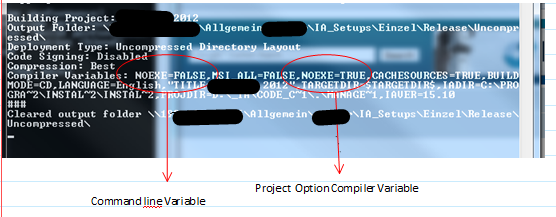

bug???:
when NOEXE is set as a Project Options compiler variable, it can't be overridden, when passing it in when doing a command line build;
= miabuild.exe <myprojectfile> NOEXE=FALSE...
Scrrenshot from Cmd.exe when using command line:
Do we something wrong?
reagards
NOEXE= is not overridden with miabuild.exe

Dear Rulan,
just to confirm that the issue has been logged to our fixes list.
Currently, I can't say about the availability of the fix.
Re: NOEXE= is not overridden with miabuild.exe
Dear Rulan,
just to inform you that a fix for issue you reported, it is available with our new InstallAware update 15.32.
