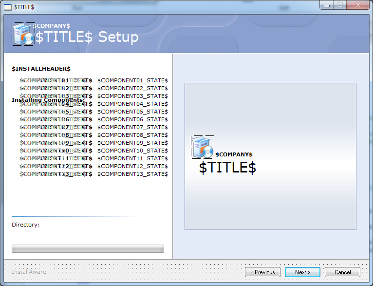

Does anyone know if it's possible to bold a label or display a second bold label to indicate the stage of the installation?
Here's a good example of what I'm talking about.

you could define several Dialog Behavior rules (using Dialog Editor) to activate those labels conditionally based on a script variable value.
I may suggest you to have a look at the following topics available with IA documentation;
- Using the Dialog Editor
- Dialog Behavior
- Passing Values from the Script to Dialog
- Intra-Dialog Relations

Ok, I think that's what I settled on. I created three labels: lblComponent01 (for regular text), lblComponent01_Bold (when in progress), and lblComponent01_Grey (when waiting to install). Each of these labels are invisible by default and their caption value is set to $COMPONENT01_TEXT$. I also created another label named lblComponent01_State. This label is also invisible and its caption is set to $COMPONENT01_STATE$.
Now when I update the COMPONENT01_STATE variable to say WAIT lblComponent01_Grey is made visible (INPROGRESS - lblComponent01_Bold, COMPLETE - lblComponent01). Almost there!
But I think I'll hit a snag. See I'd like to display the features that the user selected as a label on this dialog. It sounds like a simple problem but if I call Get Component State it's going to mess up my installation because this command is used for calculating disk space and such. Any hints on how to deal with this?
