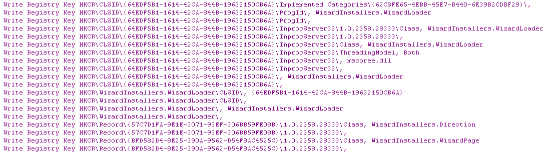

InstallAware generates the MSICode in the attached PNG image

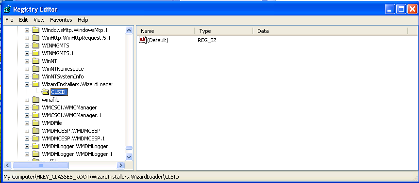

Postby skibbs » Fri Jun 16, 2006 7:57 pm
After installing my application with the .REG file imported via the tool, my registry entries for this simple example look like this...

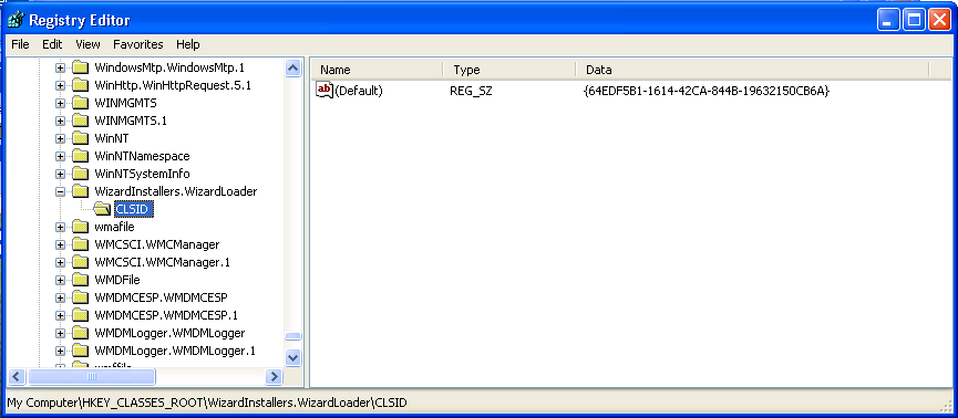

Postby skibbs » Fri Jun 16, 2006 8:00 pm
After deleting the InstallAware entries and manually running the .REG file on the client machine my registry looks like this... which is correct.

Postby skibbs » Fri Jun 16, 2006 8:36 pm
I get the same result, whether I use the Import .REG or use the Register Assembly commands... I've attached a screenshot of the registry after using the Register Assembly command.
