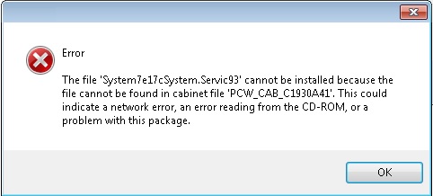

I have create the web deploy for my (web) application using Installaware developer 11 and it is working fine. But, when i create the patch I am getting the following issue.
"The file 'System7e17cSystem.Servic219' cannot be installed because the file cannot be found in cabinet file 'PC_CAB_8D4F2A0E'. This could indicate a network error, an error reading from the CD-ROM, or a problem with this package."
Here i have attached the screen shot for your reference, Please assist on the same.
Installaware - Patch issue
- PatchIssue.jpg (25.89 KiB) Viewed 14901 times
Re: Installaware - Patch issue
please verify that "Setup Source files" with both packages (the base project and the patch project) are forcibly cached.
This option is controlled by "Always Cache Setup Sources (enables easy patching)" flag available with "Build Settings" page in IA IDE.
"This three-state check-box lets you control setup source caching. When the box is filled, the default source caching option (as described above for each build type) is in effect. When cleared, setup sources are never cached. When checked, setup sources are always cached."
Please refer to IA documentation for more details.

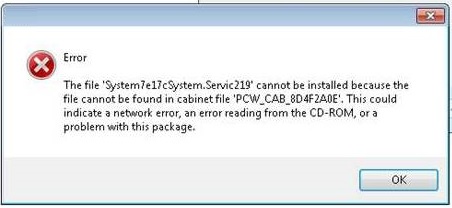

I have tried the same referring the IA document, still the issue persists. Attached screenshot for your kind reference and please suggest how to proceed with.
Thanks for your reply,
- PatchIssue1.jpg (31.69 KiB) Viewed 14876 times
have you followed the steps described with the following topic?
http://forums.installaware.com/viewtopic.php?f=2&t=8847&start=0&hilit=patch
Are you able to execute correctly the patch sample project available with the link below?
http://www.installaware.com/forum/viewtopic.php?f=2&t=9343&start=0&hilit=patch

Your patch project uses a different UPGRADECODE ( ... and probably there are also other differences ... I haven't investigated further) and due of this, it fails to work properly.
To fix the problem I have created a new patch project (MAKING THE EXACT COPY OF THE BASE PROJECT) and replaced the files to update.
IT WORKS FINE!.
However, because your patch replaces all files installed by the BASE PROJECT, the size of the two setup packages emitted is quite similar.
You have to keep in mind, that a patch is created on the binaries differences that exist with all the projects involved with the patch project.
Please have a look at the available IA documentation about the argument.
I really hope that this finally clarify all your doubt.
NOTE!
If you wish to rebuild the patch project, please update the patch reference (... using a path that reflects your effective system path).
It is not required any other action to rebuild the attached projects.
As I told you previously, the patch project must be the EXACT COPY OF THE BASE PROJECT.
The sample you supplied uses as patch project that it is NOT a copy of your base project .
IT WORKS FINE!.
NOTE!

Dear Francesco,
I have tried installing base build and patch project you have provided, The patch project got installed without any error (mentioned in the previous posts).
But I found the base build files were deleted from the installed path after this installation.
What could be the reason behind the deletion of the files ?
Could you plz list the steps you did for building this patch, as I am getting the error still here?

Dear Ravz,
I'm very sorry but I don't understand if you found the sample I sent you not working or if you are referring to your real project.
Regarding the steps I used, these are those already indicated with my previous posts.
Basically, I have just created a new Patch project instead of using the one you supplied.
As I told you with my previous post;
...the patch project must be the EXACT COPY OF THE BASE PROJECT.
IT WORKS FINE!.

Dear Francesco,
I found the base build files were deleted from the installed path (sample project which you provided) after this installation.

Dear Ravz,
honestly, I do not find those files deleted by the patch installation.
Which IA version are you using?
