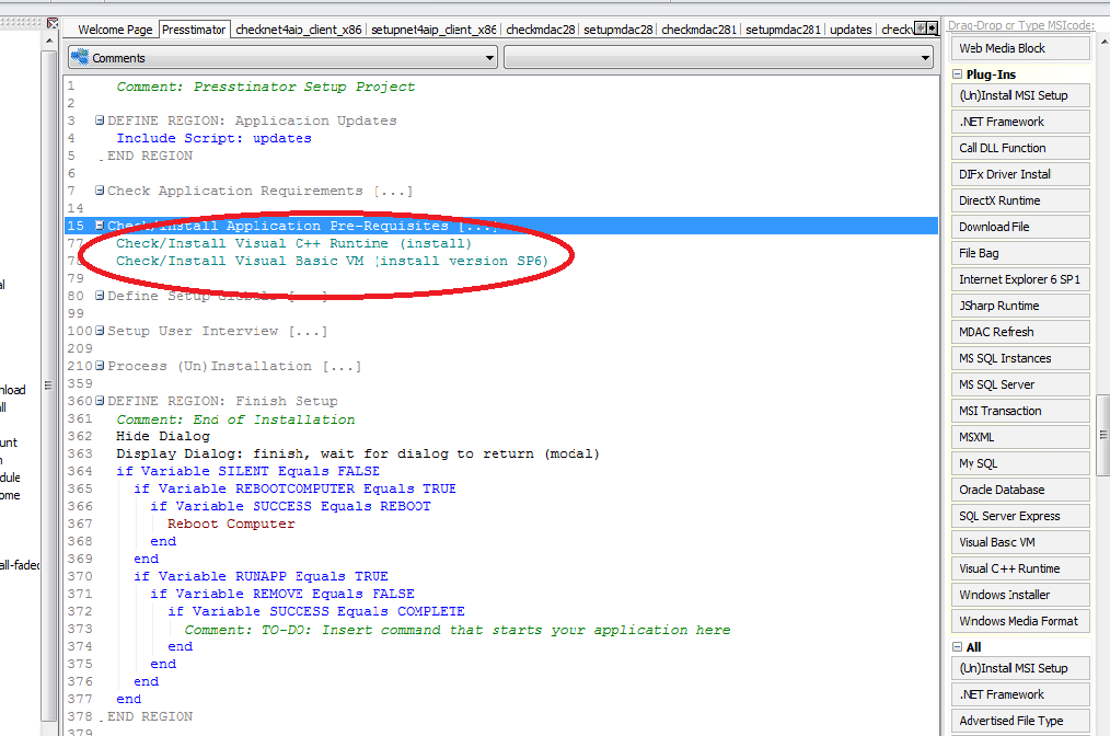

Thank you for your response! I looked all over and couldn't find where to include Plug-Ins so I really appreciate your help. Once I went to the MSIcode tab, I saw the list of Plug-Ins on the right. The ones I was looking for (VB6 and VC++ 6) come with IA so all I had to do was include them in my install. I wasn't really sure "where" they should be included though. Here's a screenshot of how I included them. I haven't tested it yet, but it looks like this is on the right track. Please let me know if the Plug-Ins need to be in a particular area of the MSI code. I need these Plug-Ins to be installed before my application as they are needed for registering the DLL's I will be installing. Without the VB6 and VC++ runtimes, I will not be able to register my controls as they are dependent on these base runtimes. I'm guessing that these runtimes are not included in the "runtimes" list is because they are "older" runtimes. Until we update these older controls, we still need these older runtimes. Thanks again!!!

Dear Mike,
You should place the runtime check plug-ins within "[DEFINE REGION: Check Application Pre-Requisites]" and within the "[compiler if Variable BUILDMODE not Equals PATCH]".
Then place the runtime install plug-ins within "[DEFINE REGION: Install Application Pre-Requisites]" and within the "[compiler if Variable BUILDMODE not Equals PATCH]".
A trick, if you just add any other IA runtime available (... as for example the VC++ 10 runtime), you can easily verify where is the correct place to include them with your script.
Once you checked where in the code InstallAware automatically have places the required Check & Install runtime scripts calls, remove the just added runtime from your project by deselecting it within the Runtime page in IA IDE.

Re: Include Plug-Ins vs Runtimes
Awesome advice!! I'm slowly figuring this out (I think). Here's how I inserted the Check.
And here's how I inserted the Install:
Dear Mike,
it seems to me all quite right.
does it work as expected?
