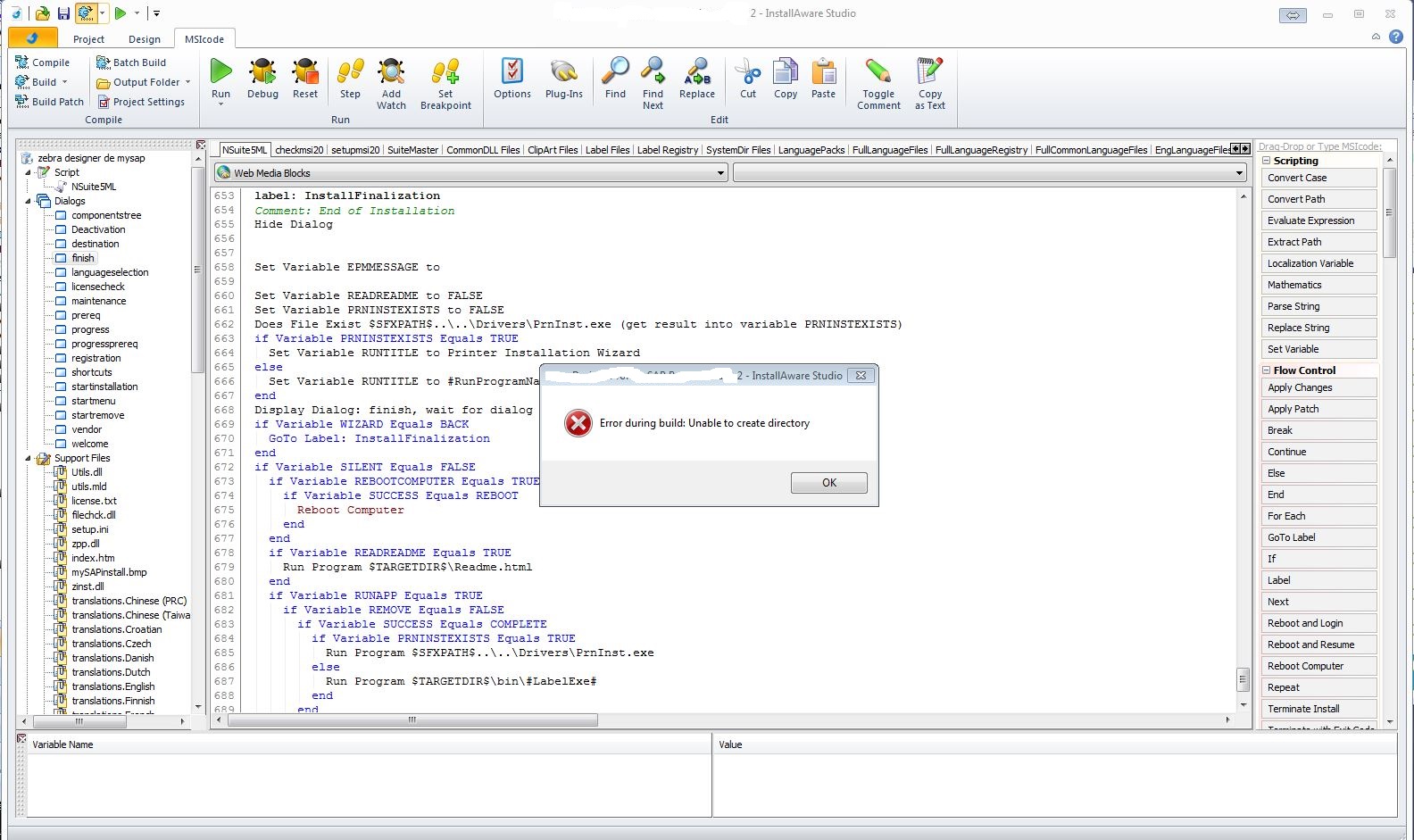

I took over an installation project that was build command line but I would like to build in the GUI to be able to debug.
When compiling the build I get the error during build: Unable to create directory
Does anyone know what may causes this?
The command line build works perfectly but it will not produce a debuggable project.
While compiling error to create directory

Alternatively, could you post a screenshot of the build process window?

The project consists of many different scripts and one main script.
Attached is a picture of the build error if this is what you were asking for.

- Build error
- buildProcess.JPG (361.54 KiB) Viewed 5807 times

Do you pass custom compiler variables when you run the build from the command line?
If true, are you sure that these compiler variables are correctly initialized when you try to executed the build via IDE?

Hello Francesco,
finally got back to this issue and yes you are correct the project takes custom compiler var's which I didn't know in the beginning.
I got it working now.
