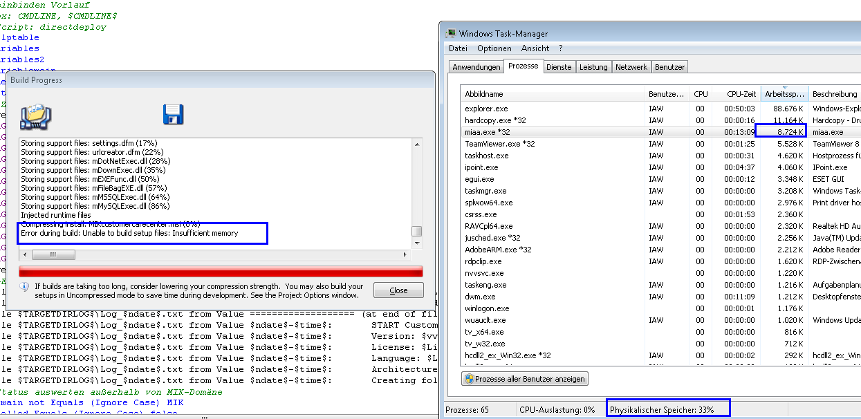

Same problem in IA18 with UniCode Project. 180GB free space, 8 GB RAM, no video included but the new button stle with the arrow.
Kind regards
Heiko Kummerfeld

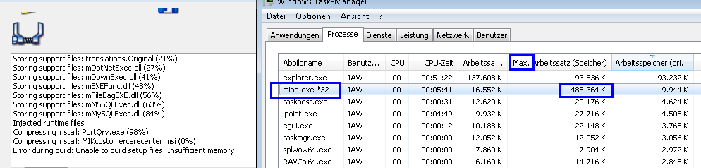

Re: Insufficient Memory Errors
Hello Guys,
when I build my exe file on the best and second best compression it always results into that error, but only with IA 18, IA15 is fine.
We have enough memory.. No extra DLL or EXE files are added into the project...
Where is the problem ?
Hi Heiko,
Are you running the latest build - 18.03?
I've still been a bit gun shy since v16 and v17 because of random memory errors. According to the blog they have been fixed in v18. I did build a 1.4GB compressed install with no issues in 18.03.
http://www.installaware.com/blog/
Steve
Steve
Dear Heiko,
honestly, I am not able to replicate the same.
Anyway, I believe your screen-shots only report the system processes state after the error is occurred... and not while it is triggered.
You could use "Process Monitor tool" to have a more detailed picture of your system state
http://technet.microsoft.com/it-it/sysinternals/bb896645.aspx

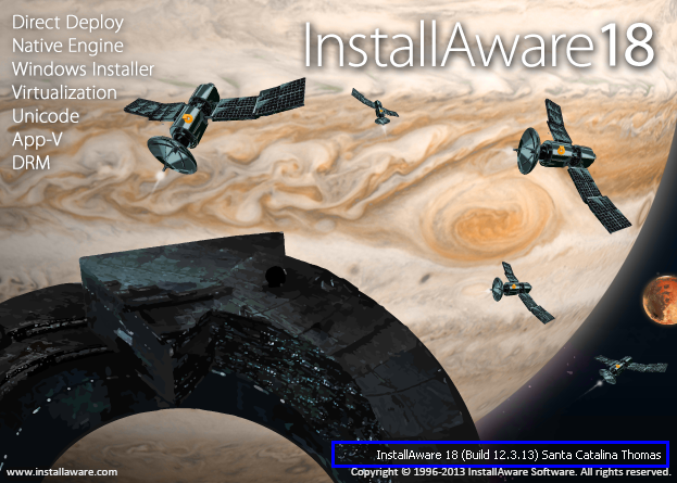

by the way this is my exact Version:
Maybe you have to release a 64bit Version of IA instead of 32bit...
Okay I will do it...
The Maximum RAM for the mia process was about 485 MB RAM before it stopped building due to the error. At this time, I had 1.5 GB of physical RAM left...
Please find a soultion as I can not build this Project anymore with compression...
