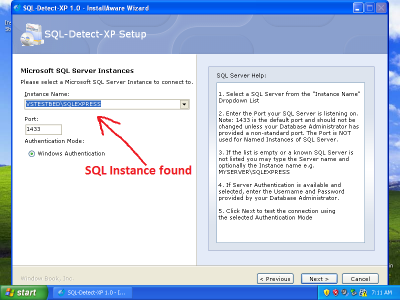

Re: MS SQL Instances Fails on XP SP3
Dear Steve,
... sorry I missed to reply to you.
I tried to test your project, but I am not able to replicate your possible issue.
I used several WIN XP target OSes to test the package and the active MS SQL Instance has been always detected (see screen-shot below).
