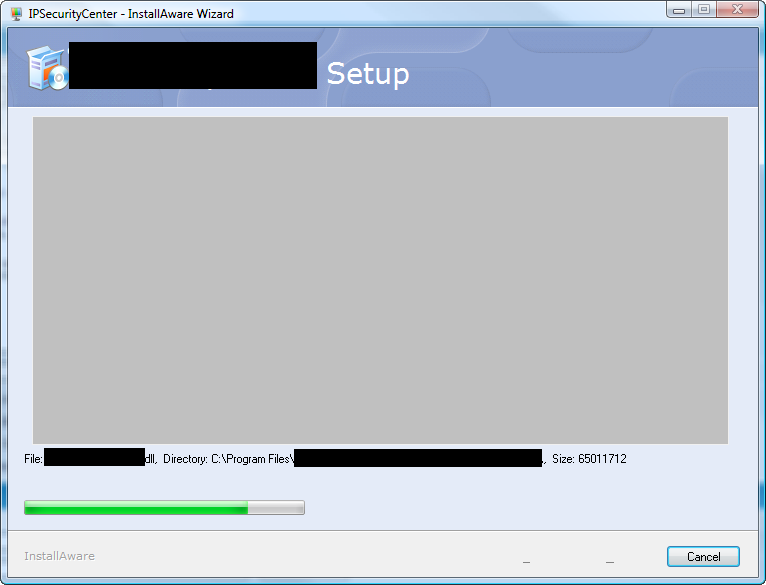

I have the same problem, and I have set the receives information to installation billboards.
The image from htm is not displayed and it is included in the creatives.

The image is displayed in setup as a missing image thumb.

I have ceated an empty project and it works. So I have re-created the entire stup again and now the image is displayed. Strange.
