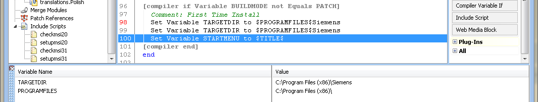

I've found a problem with setting TARGETDIR Property. I would like to get something like \Program Files\Company\Product.
So I decided to modify Application Information | Project Properties | Target Folder to
$PROGRAMFILES$\Siemens\$TITLE$

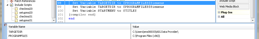

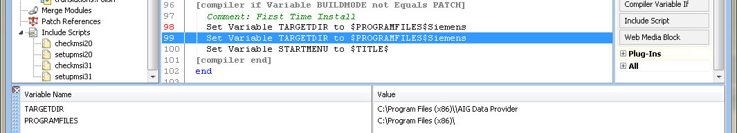

But application tries to install into Program Files\ and then Ttile (without Siemens). I started debugging on MSIcode tab. Then I found something strange. Set variable doesn't set to specified value. So I decided to add extra "Set variable" block. And the other one with the same arguments works fine. 8) Why?
Here is a screenshot with watches (slightly modified arguments - without TITLE).
Before entering first set
After first set
After second set
best regards

The issue can be resolved by removing original set variable TARGETDIR with one added manually with the same settings. Maybe something wrong with synchronisation between design and MSIcode?
