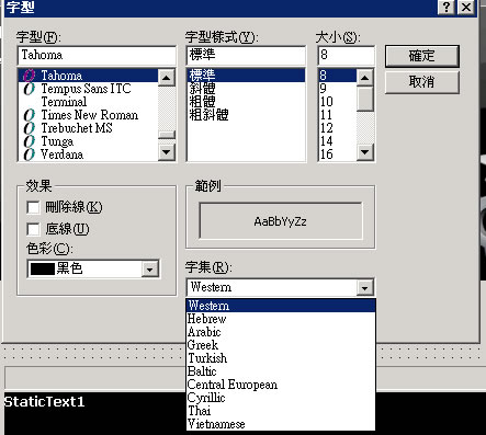

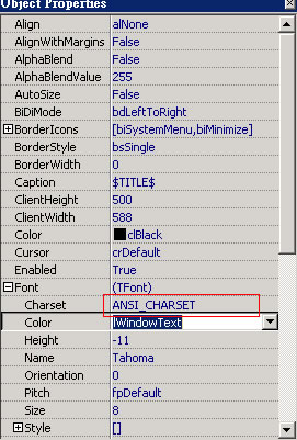

I am new user of InstallAware Studio , and I face the same problem.
Do you have solution now?
I am use Chinese(Taiwan), Chinese(PRC) and Japanese also.
I found some thing and I do not know is that useful for you troubleshooting
When We modify a Text on dialog, We use font Tahoma to solve translation problem,
And on font select dialog, Charset is Western, In Object properties is ANSI_CHARSET
If use this setting, we will get chaos character on translation result.
We must change from ANSI_CHARSET to DEFAULT_CHARSET and it will translate will.
But in resource editor, we can only select charset on font select dialog, not like in installaware editor we can change ANSI to DEFAULT.
