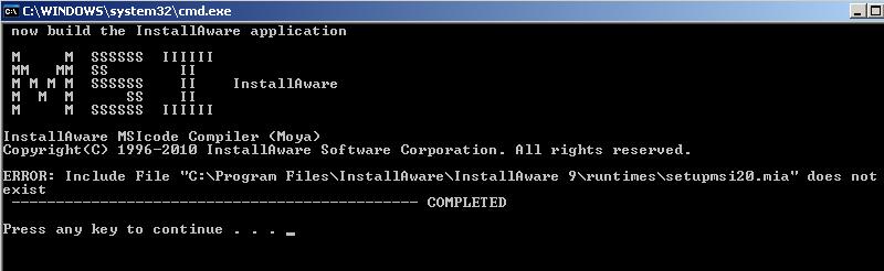

Well the file (miabuild.exe) was in the installer when selecting the full install option as you mentioned. Due to it not being in the default setting of minimum install, it was missing during my upgrade. Why is this not included i the minimum install as to get it I had to download the whole 1.5 Gig single file to get a file of 9 meg?
Anyway, all that aside now, when I execute the exact same batch file (contents below) the built promptly stops with the error in the attached screenshot. Why does it report more file missing even with the full install?. May be I should get that free upgrade that you offered after all! I ran the batch file bfore the upgrade just to make sure that it worked, and now it doesn't. Any suggestions?

- Error when executing the batch file
- untitled.JPG (31.08 KiB) Viewed 9175 times

You didn't have to download the full single file install; you could have just re-run your existing installation in maintenance mode to add just the command line build module. This would have downloaded just that bit.
Your project contains a hard-coded reference to an InstallAware 9 path for an include script. Not sure how that got in there, but you can update the .MPR file in Notepad to update the path to the new install location.
