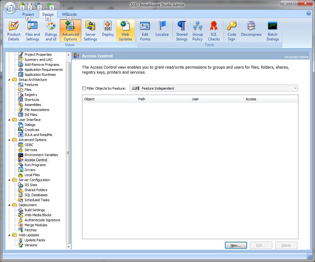

Take a look at the Access Control section under Design/Advanced Options:

That's where I started but the options are read, write or full and putting read, write (but not full) still end up with full.
What I need is explicitly 'everyting but Full and Special'
