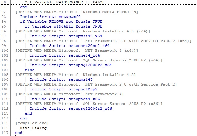

I was able to resolve the message by editing the code from:

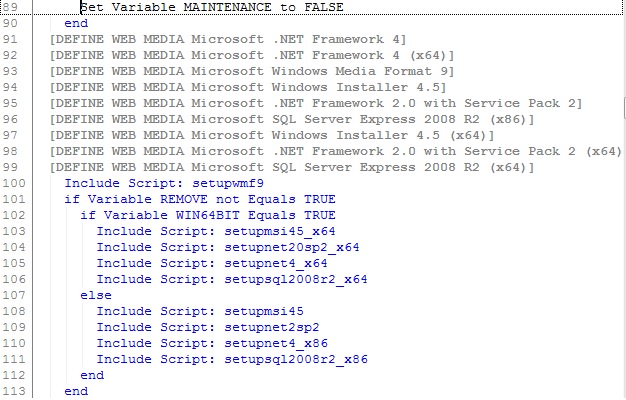

to:
