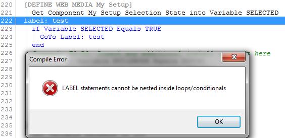

As for the label issue, are you getting the following message when compiling:
KevinTX
Posts: 23
Joined: Thu Aug 05, 2010 10:47 am
Re: How to create multiple shorcuts to the same target
Post by KevinTX »
Yes, that is exactly the error message that I was getting.
Post by mills »
Then, you must be defining a label within an if block. You can place GoTo statements in an if block, but not a label definition.
