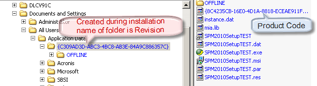

I have created an installation using InstallAware v9 r2. I am creating the Single File, with CacheSources set to True. The operating system of the target computer is Windows XP Pro SP3. Upon installation there are some hidden folders that remain on the system and it is desired that they be removed.
Steps to repro:
1. Create installation
2. Run installation
3. Uninstall using the Add/Remove programs

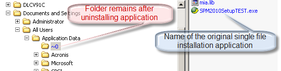

Actual Results: After installation a hidden folder exists in the "Common Application Data" folder. The name of the folder is the Revision Code. This is expected. After uninstalling the application there is a hidden folder in the same location but this time the name of the folder is "~0". The contents of the folder is a file named mia.lib and the single setup file.

"So, the hidden folders are being added by your installation?" - yes, but not through anything I have specifically done to do so. See graphic below...
"Do all of the hidden folders remain or only one?" - The one that was created during installation is deleted, but a new hidden folder is created. It is "~0", unless it already exists then it is "~1", or "~2", etc. See graphic below.
