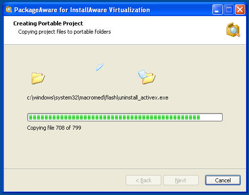

Trying to repackage an Installaware setup as a virtual package using Packageaware for Virtualization.
MPA process jumps 10 90+ CPU utilization when copying files to standalone project.
Is there a way to provide debug/logging information to determine what's going wrong?
I am using a virtual Windows XP machine as my baseline computer, with 1GB RAM and 30GB free disk space.

At what point are you seeing this?
A screenshot might be helpful.MPA process jumps 10 90+ CPU utilization when copying files to standalone project

Re: Packageaware for Virtualization - debug logs?
I chose to create a portable project. Unchecked the other options.
- Point where CPU hits 99 percent
- lockup.jpg (35.08 KiB) Viewed 5596 times
I am using Packageaware for Virtualization, whose EXE is mpa.exe, not packageaware.exe
It didn't like the Flash EXE files (uninstall_flash.exe, flashutil.exe, so I ended up bypassing ?:\Win*\System32\Macromed\Flash\* to get past it.
Then I got the same problem on \windows\system32\vb6stkit.dll. AAAARRRRGGGHHHH!
Why is MPA handing on these system32 files?
By the way, running MPA.EXE /L=C:\MPA.LOG doesn't generate any log files (This is an XP SP3 virtual machine, and I am logged in as Administrator)
